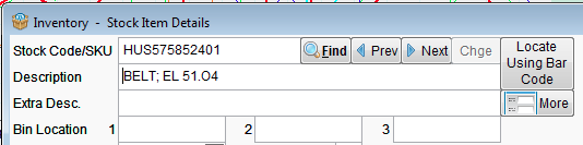

IT is a Gates 7027BR
Right now the catelogue link is not working for me so I can not give you the specifications but if you click on the BR number above it might work for you
Apparently NAPA use Gates numbers so you could try ordering one through them .

I am coming up with 539120806 for your belt number which is available. The part number that you listed is for the 42 inch mower version not the 30 inch version in your post.
114
12,382
Gates 7027BR is 1/2 x 51.25
The Husqvarna 575852401 is 1/2 x 51 effective length.
The Husqvarna 539120806 is 1/2 x 47-1/2.
So Bert's suggested Gates is the closest to 575852401 as effective is usually a tad shorter than the OC.
But as IL said the 539120806 is the drive belt listed for the RZ3016.
