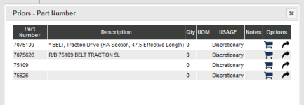

Hmmm that not what the Stens website is showing.
Briggs Power Portal is showing the following belt size for the 7075109YP
