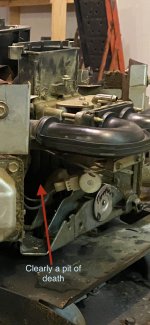

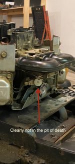

So just after posting that, I answered my own question. :D I was going to delete this thread.
But after reading your responses (thanks, by the way), I realize that I didn’t state my concern/question very clearly. I was concerned about the area the solenoid occupies when mounted on the carb and engine - I didn’t think there was enough room for the new solenoid to actually fit between the carb and engine.
I remembered I still have all the pics of the tear down (great way for the parts to go back where they belong) so I started searching through them and found my answer.
My recollection was that the solenoid faced about another 90* to the left and resided in that pit of death looking area.
But as you can see, my recollection was falsified.
So there wasn’t any problem to begin with - I’ve still gotta work on that whole patience thing.
Thanks! ?
