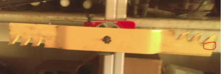

Just to show how sensitive these ball bearing type balancers are.
Before
After a small paper clip added to light end.
My gram scale won't even register its weight so the clip is well under a gram. And that is probably just a variance in the paint thickness.
So yes it very sensitive and actually over sensitive for mower blades.
I tell people who watch me balance their blades that goal isn't to have the blade be 100% motionless when it's on the balancer, just to move very slowly.

No I don't expect prefect balance but it is a lot closer so less wear on bearings and less noticeable deck vibration.
And with the balancer I now use it is a lot closer as it is a lot more sensitive than the old cone balancer and way more accurate than try to use a nail which is usually off center.
