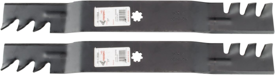

I have Rotary Copperhead Mulching Mower Blades:
on my JD along with the JD mulching baffle. These blades have held a sharp edge longer than any others I have used.
I keep the deck balanced and proper tire pressure and always get a good, even mulching cut. I never cut below 3.5" and mow as dry as possible, although it is wetter sometimes.
After two mowing seasons I have yet to find thatch buildup in my lawn in the fall, so it's been doing a decent job grinding up clippings.
