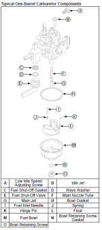

Sometimes I think posters don't even need to take the effort to get out bed at times. Especially when they have no idea of what they are doing.
From the service manual....

View attachment 67582View attachment 67583
thanks. where did you get that?
anyway, got fuel into the bowl. maybe i freed some debris but not it seems to over flow into the main area out into the air filter. I found the needle valve to work against my lungs through a tube on the fuel inlet so not sure what that means. I have two other carburetors I test with...
The Kohler XT series service manual. DUH
Jets submerged in fuel or not will clog over time.
