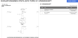

Post model type and code no. so someone can look it up.
PH-XT675-2070. What's "code no"?
Where do you look it up?
