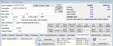

Houston we have a problem.
Your wiring is not matching the model number given. Also the 539113792 switch when I look it up here and on the internet all are showing a 3 pole switch and not a two pole switch. Btw I have a couple of the switches setup for my next distributor order as they are the same as the CUB ones I need but at a quarter of the price.
Look like rewiring is needed so it matches the wiring diagram. This depends how good you are at following the wiring schematic and have appropriate wire, terminals, and housings or you just replace the harness and install the correct switch.
Harness is PN 515980501 > 580798101.

119
12,782
Well I can't just ordering a $6.50 switch and pay $16 shipping + the below minimum surcharge to get it in from the Husqvarna distributor just to prove that it is indeed a three pole switch.
