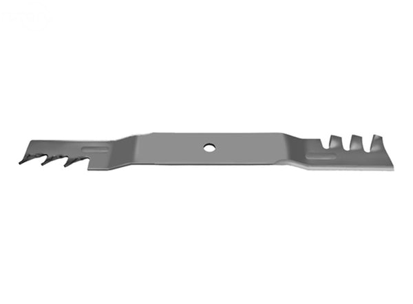

There are Toro part numbers on those Oregon blades. Your Toro part number isn’t there. They may work out for you anyway. If the blades are slightly tucked inside of the deck, that’s a good thing. Toro blades will sit somewhere between 1/4” to 3/8” above the bottom deck lip. They may also be 1/16” shorter than your Toro blades. If that’s the case, you may notice an uncut strip of grass in the middle of the rows that you’re mowing. You won’t know, unless you try them.

cool yup that all makes sense! thanks everyone for sticking with my probably over analyzing and obsessing about this haha
actually these are a tiny bit (about 1/16th) longer than the stock toro blades in my measurements or at the very least the same.
I see what you mean about the toro part #'s actually....misread that. I did notice mine is not on there but i remembered that Oregon told me that they are behind on the newer toro models so hopefully due to that. the blades come within 1/2" of the outter part of the deck and within each other which all is good i know....but the only thing i was concerned about is how close to that bottom lip that they come but as long as i keep them balanced and they dont hit that i'm sure i'll be good.
I agree though, wont really know until i try them out. once i can torque them on tomorrow and fire it up to see how they sound i wont know for sure (the stock blades spin up smooth and fast vs the g6's labored a bit and a bit louder so i expect the g3's to be closer to stock
