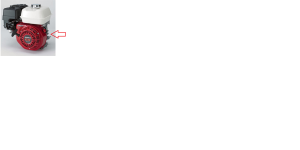

If you can find it, a model number. IF it's a briggs and stratton, it will be stamped into the valve cover, if it's a predator or "Honda clone" motor, there should be some numbers stamped into the back of the block.
Sir is the back of the block considered at the rear where the muffler is?
