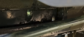

Has anyone faced a similar issue after trying to reattach the cutting deck on the Husqvarna rider? Had no problem removing the cutting desk, but now when trying to attach it, I'm unable to align the screw (nr 1 in the screenshot) and the metal pin (nr 2) on the left side. If I fit the pin, then I'm unable to align the scren and the other way around. What am I doing wrong?

I seem to be doing this, but now I am at a point where I'm thinking whether the frame is maybe bent? there is a slightly curve, though I am not sure if that is expected or not.
This is what I get when I try to connect it. If I try to lift the from for bolt hole to match, then the 2/3 blocks it (If my thinking is correct)
This is pretty much closest, I get, but it is not aligning any more

Never mind me, looks like I just had a brain fart for a couple of days. Rewatching tutorial videos, the locking pin does not have to be in place when mounted, it is only used for service position if I understand correctly 😵‍💫
