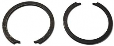

Hmmm Good to know about the clips, I was thinking they were snap rings.
Yep, I think even the JD parts list lists them as Snap Rings, here's what they look like. They are regular circlips, not spiral circlips like I stated earlier.
10 - SNAP RING​

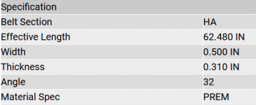

She's definitely in need of a new belt, Part Number M112006
Wonder why the 1/2" discrepancy in lengths?
114
12,428
I would stick the OEM spec belt. The extra 1/2 would be a looser fit and would wear out a lot faster even if it works.
The M112006 specs>
The 266 belt is supposed to be an exact replacement
The 248 belts are just wrapped kevlar belts in standard lengths
When the tension is applied via a spring there is some lattitude with the belt lengths
In most cases +/- a little works fine
As pulleys wear I often fit a smaller belt to compensate for the smaller effective pulley diameters .
Back when engineers were real engineers things like decks would be designed to take a standard common belt
All of the local Australian ride ones use plain polly belts in whole inch sizes .
Belt makers have plug in design application so you plug in the pulley size, torsional load & centres & the app spits out the belt length
Thus you get a 201 23/64" belt when in reality the 1 & 23/64" is total rubbish and only true when the deck pulleys are in line with the engine pulley .
Almost nothing I regularly work on has original size belts because I usually either fit a smaller one as above or an alernative belt that is substantially cheaper
When you get to ZTR belts which are all well over 100" +1" to -2" makes no difference , particularly if the tension spring is adjustable .
So for instance the deck belt on a Dixon Ram 60" is $ 278 .
Replace the eye bolt and you can fit a 2" shorter belt for $ 110 or a longer belt for $ 105
One customer changed to 7/8 standard belts on his which are $ 40 each
They last 3 to 4 years against the kevlar belts which are good for 3 to 5 years but at that price he does not care if they need replacing every year
They do wear the pulleys more though .
