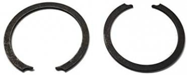

Hmmm Good to know about the clips, I was thinking they were snap rings.
Yep, I think even the JD parts list lists them as Snap Rings, here's what they look like. They are regular circlips, not spiral circlips like I stated earlier.
10 - SNAP RING​
Part Number
J2376M

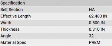

Got the deck back on, I'm now not quite an expert on these older JD's... lol.....
She's definitely in need of a new belt, Part Number M112006
Wonder why the 1/2" discrepancy in lengths?
The 266 belt is supposed to be an exact replacement
The 248 belts are just wrapped kevlar belts in standard lengths
When the tension is applied via a spring there is some lattitude with the belt lengths
In most cases +/- a little works fine
As pulleys wear I often fit a smaller belt to compensate for the smaller effective pulley diameters .
Back when engineers were real engineers things like decks would be designed to take a standard common belt
All of the local Australian ride ones use plain polly belts in whole inch sizes .
Belt makers have plug in design application so you plug in the pulley size, torsional load & centres & the app spits out the belt length
Thus you get a 201 23/64" belt when in reality the 1 & 23/64" is total rubbish and only true when the deck pulleys are in line with the engine pulley .
Almost nothing I regularly work on has original size belts because I usually either fit a smaller one as above or an alernative belt that is substantially cheaper
When you get to ZTR belts which are all well over 100" +1" to -2" makes no difference , particularly if the tension spring is adjustable .
So for instance the deck belt on a Dixon Ram 60" is $ 278 .
Replace the eye bolt and you can fit a 2" shorter belt for $ 110 or a longer belt for $ 105
One customer changed to 7/8 standard belts on his which are $ 40 each
They last 3 to 4 years against the kevlar belts which are good for 3 to 5 years but at that price he does not care if they need replacing every year
They do wear the pulleys more though .
I have differ on that Bert. I had a JD 737 the needed a new mule belt. I got in what was supposedly the right length belt in an after market belt. I could not it on. I measured it and it was nearly 3/4 shorter than the JD belt. I went and got the JD belt which measure as spec'd and it barely went on.
Plus on especially MTD CVT systems you better have the OEM belt as the after markets belts just don't work.
I finally had to get a belt measurer that can handle up to 200" belts as so many of the after markets are either too short or too long. I had so much trouble with A&I belts coming in 1-2" short I just gave up on them. They are very good belts but I can't fit them properly they are of no use. I actually got rid of a $1000 of them from my inventory because of this. I had regional sales rep to come out last and ask me why I quit buying the belts and I explained to him the problems. When a small shop like stops buying a $2000 in belts each year it does get their attention; although, they still haven't resolved the problem as he said no other shop is complaining about the belts.
There are some cases where the OEM or OEM Spec belt is essential but that is not the norm .
It is a bit different over there where you don't get stung $ 200 for a hydro belt for one model then find one 1/2" shorter for $ 75 .
It took a long time for me to come to grips with mower belts but now i have it has made a big difference to my bottom line & my customers running costs .
