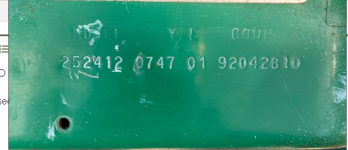

BUT I need to know what model/type/serial number this 11hp B&S engine is and for the life of me I can't find the numbers, can someone direct me where the number is?
It looks like I bought a new float gasket in 2017 which has a part number (692215 Carb Body Gasket)
I would like to have the model/type handy incase I need to buy new carb parts, thought there really isn't much left other than the float needle. and maybe ignitor.

On the older Briggs engines the model, type and code numbers are stamped into the engine shroud, sheet metal cover which surrounds the engine and has the recoil mounted on it. Most of the IC engines had it stamped next to the decal. You should also look at the flat surfaces of the shroud. Remove it and tip it around in a bright light, it should be there, on one of the flat surfaces.

  • / Need help finding model number of my 11hp Briggs & Stratton - PowerMate Generator (1992)
lordy I was going nuts.... FOUND IT....it WAS on the recoil shroud, but very faint
I ended up painting the embossed numbers and wiping away the excess paint to see better
model type code
252412 0747-01 92042810
