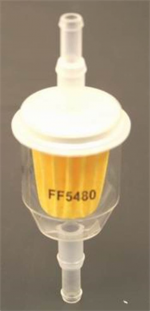

are we talking like one of these filters?
Or
If it's FUEL filter, there should be gas in it...

No, it’s an air filter. I think we’re talking about 2 different filters.
oh yeah, shouldn't see gas sitting in the air filter...
