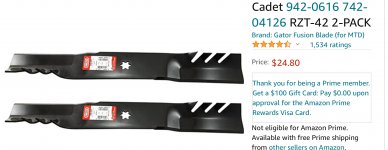

I’m having the same issue with my CC 42 inch lawn tractor. I installed the best hi lift mulching blades from Amazon along with the CC discharge plug and the grass clipping mounds are left all over my lawn, especially if I back up with the mower. It then leaves a big clump of grass.
Would I be better off using these blades but removing the discharge plug and reinstall the discharge chute? Thanks

  • / Mower deck gets packed with grass - Cub Cadet XT1 (LT50) - Please help!
Most often when you see clumping, it is the result of trying to cut too much at a time. The rule most of us use is never remove more than 1/3 of the grass height at a time.
You are probably right and I need to do something to get a better seal with the mulching plug since grass is always getting stuck in it and squeezing through.
