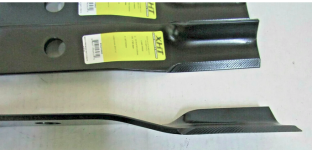

I must have thought they were flat the first time or I didn't notice that. My apologies. I do need the "offset" and "air lift" as pictured. I'm learning a lot about blades as I go (lol). I'll have to measure mine. I butch my grass so I would hate loosing height by using a blade without an offset.
I did put the old blades back on and measured the minimum distance between blades and all the way around and it was 3/8". So now I'd be down to 1/4" which would be doable. If I have trouble locating those, I'll get back to you....Thanks.

Update:
This is what I ended up with. 20-15/16" blades just missed each other on a trial fit. So for comfort, I ground off 1/16" each end and made sure the blades were balanced. Mowed the grass twice until the belt broke. Got another one and will install tomorrow. Don't think it's added pressure on the belt since the blades are the same thickness design. Belts just break. and I had the same problem a couple of years ago. Went through two belts back to back. Found out the belt retainer post was dragging. Moved it out of way and re-tighten. Worked fine. I think I may have bumped it when removing the deck.
