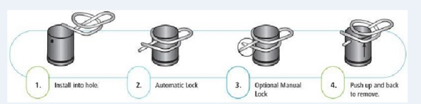

Now you why we charge so much to do the work and wait until you find that Rue Ring on that connecting link. Just follow the link to its mounting point on the brake cross rod.
Here is the instruction on how to remove and install the Rue Rings.

LOL! Yep. After I went back to it with a fresh set of eyes I realized that I could get to the other end of the rod through the battery box after I removed the battery - and then I saw what looked like a grossly mangled cotter pin holding it in! Not sure exactly how exactly I managed to get it off, just random frustrated series of pulling and twisting - but thanks for the illustration, that should make getting it back on a bit easier anyway.
