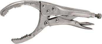

Have you tried an oil filter pliers? Google one and you should be able to find one. Some auto auto parts store even have free loaners.
Don't know how tight your filter is but Hobofreight has this one.
