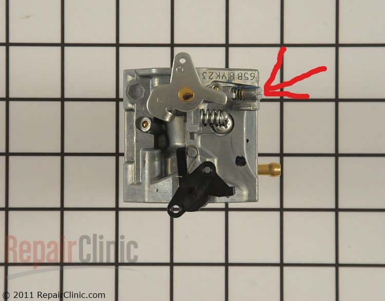

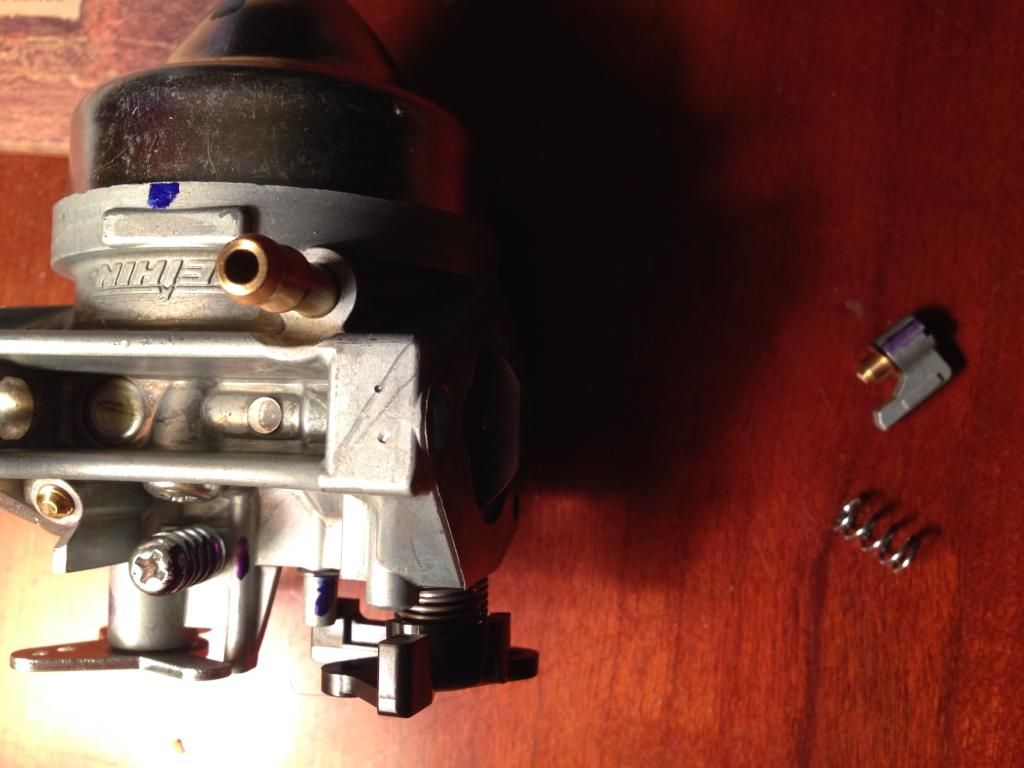

Looks like this is where my carb broke in shipment.
That is the air/fuel mixture screw. Per EPA regulations, it is designed to be tamper-resistant, so as to not allow a consumer to change the emissions of the engine. Part of this tamper-resistant design is the screw is narrow in one section, and if you try and force it,
it will snap off. Legally, the remaining bit of the screw must be drilled / extracted, and a whole new screw installed. That said, the carb should work just fine since you don't need to adjust the screw, so not having the top part (or tension spring) won't change the way the carb operates.
Probably just return the carb to the seller or file a damage claim with the carrier?
