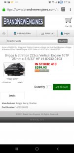

I sent them an email to fund out if that 10tp will work.
JASTECH
Jun 10, 2014
37
They replied:Thank you for the information regarding your engine. Unfortunately the information provided does not register as a valid model by the manufacturer. Please check and resubmit with the complete model and type number.
So I sent them this photo.
