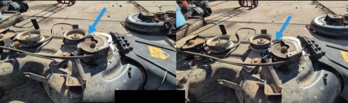

Missing bolts usually cause the Camber to be off allowing the belt to enter the pulleys at a wrong angle

Now I just did an Ariens Ikon-X ZTR where the drive belt needed replacing. The owner complain about the two hours it took to replace it. It had a v-idler that was offset enough to cause excessive belt wear. That had to be fixed first. Now the customer wants to change the belt himself next time. He don't realize the unit has to be put up on jack stands for clearance, the transaxle brace removed. The deck belt removed from PTO clutch. The PTO clutch removed. The drive idler arm spring removed which the strongest I have seen. I also have a special tool remove and install the spring. On this mower it even took a ratchet strap on the tool to be able pull the spring in place. Yes next I might be able to do it under 1-1/2 hrs as the first time always takes longer as we got to figure out what the OEM did to us. Looks simple but is it does take a lot to do.
Good luck installing a new belt fellow Ariens owner. I doubt any home owner has the proper tools at hand. It not a job for the inexperience to do either.
