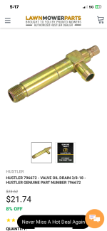

I cannot believe what I did and it worked. I thought I’d try it. I ground down one of my cheap old sockets and was able to get it on the drain hose nut after cutting interference out of the way. It came off!! No lifting engine. The hustler replacement part for the piece of crap that came on it is basically a pipe you just screw in with a nipple for a drain hose and a valve on it to open and close to drain.
