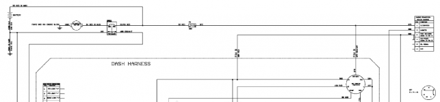

Another question........ If I remember correctly and I will verify in the morning, the B+ wire coming had voltage going to it with the key switch in the off position.
Am I right in assuming it should only show battery voltage when the key if turned on and not have continuous power at all times?
If that's the case is it possible the key switch is defective and causing the problem instead of the rectifier or the stator?
Depending on how the system is wires. Having battery voltage at the B+ terminal is normal in most cases and is the preferred method by Kohler. Some mower manufacturers will wire it through the key switch, but in a lot of those cases there is also an amp meter on the dash, and the system won't work with an amp meter if the regulator is wired directly to battery power.
