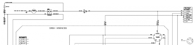

Another question........ If I remember correctly and I will verify in the morning, the B+ wire coming had voltage going to it with the key switch in the off position.
Am I right in assuming it should only show battery voltage when the key if turned on and not have continuous power at all times?
If that's the case is it possible the key switch is defective and causing the problem instead of the rectifier or the stator?

Depends upon which rectifier is fitted .
Some draw a tiny current 24/7 while others draw none
Some ignition systems ground out the alternator to turn it into a vary inefficient electric motor in order to stop the engine quickly .
While all mower wiring is basically the same there are quite a few variations.
Not uncommon to find the rectifier wire hooked into the battery feed wire to the ignition switch and even worse often after the fuse .

Depending on how the system is wires. Having battery voltage at the B+ terminal is normal in most cases and is the preferred method by Kohler. Some mower manufacturers will wire it through the key switch, but in a lot of those cases there is also an amp meter on the dash, and the system won't work with an amp meter if the regulator is wired directly to battery power.
