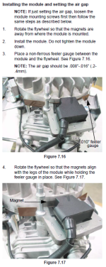

I installed a brand new coil. Still will not start. I put a tester between the spark plug and boot and I'm seeing no spark. I also attempted to disconnect the kill switch wire as suggested and still nothing. I see that there is an adjustment for the coil to be spaced off the flywheel. Not sure what this tolerance should be. Carburetor is definitely pumping fuel because after many many attempts the plug is damp.
jb2873
Jan 7, 2024
26
This is the new coil installed. I'm not sure what the Gap should be between flywheel and pick ups on coil. I have it fairly close as it is. I'm getting no spark coming out of this brand new coil. Now I'm assuming that the original coil was probably okay but there's something else going on. I've tried to bypass the kill switch by removing the wire off the coil and still nothing. I literally put my hand in line with the spark tester and there's absolutely nothing coming through.
The carburetor is pumping fuel. I cleaned the fuel bowl ( not that that is a spark issue but did it anyways). The spark plug is getting damp after many many attempts to pull start it. The oil level is optimum. I'm just not sure what is going on here LOL
I just saw on the top of the coil it said cylinder side so could this possibly be mounted upside down? LOL I'm going to flip it over and see if that makes a difference and I'll report back.

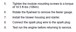

Yes, it is definitely upside down. You can use a standard business card for the air gap it is not that crucial
