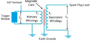

You must understand and accept due to the internal design with the electronic trigger, these coils can not be reliably be tested except with special test equipment. For us in the field [repair shops] they are tested as a plug and play item. Otherwords they are mounted and if they work great; if they don't then we replace them. The days of the externally triggered ignitions are now long gone. There a limited number engines still using the hybrid system and of course the antique engines with points and condenser system.
Ignition coils are basically a step up transformer. The testing problem rises because the electronic trigger is across the primary winding and due to the configuration any tests done on the primary side only shows the primary winding resistance. The trigger is higher resistance item but since it is mounted direct across the primary winding you only read the coil's primary resistance; therefore, there no reliable way to first these in the field other than plug and play. The kill tab is connected the floating end the primary so when you test from it to ground all are testing is primary transformer resistance.

Here is a very basic schematic of the coil configuration.
