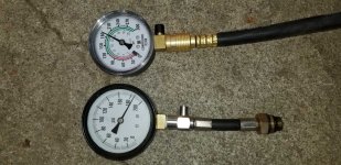

The numbers from that tester are meaningless
It is not suitable for small engines and to get a proper reading you will need to pull the starter around 100 times and even then it would be suspect.
For small engines ( 100cc or less ) you must use a tester with a solid connector or a very short connector with a valve at both ends .
Then you need the right adapter to screw into the head that has the exact same volume displacement as the spark plug.
OTOH it can be used for monitoring wear over time by noting how much the readings drop as a percentage of the new reading but absolute numbers are meaningless .
Now FWIW 65 psi, if that is real is right on the border line for 4 strokes and way too low for two strokes
I have to disagree with part of this. I use an Actron version with a very similar hose setup. The problem arises if the check valve is at the gauge end and not at the end of the hose. The Actron I use has the check valve (schrader valve) at the end of the hose right at the cylinder. With valve at the gauge the hose has to be fill on every stroke before the valve even attempts to open where as if at the cylinder end then valve opens right away and close holding the charge in the hose.
One is designed for small engines the other is for automotive but has the schrader valve at the end of the hose. Both readings from the same chainsaw
