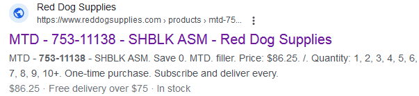

The problem for me was upon looking it up, I see that MTD only offers the entire short block assembly and I don't think I need the cylinder or crankshaft along with the rest of the parts that come with it. The cylinder is surprisingly in pretty nice shape, the piston took the brunt of it. The emissions tag was from 2022 so whoever bought it probably ran with straight gas. To provide more context here is the parts diagram I was referencing:
The Mtd part number for the short block is 753-11138. I saw this blower made under a couple different names too like Troy-bilt and I think I even saw it on Ebay and Amazon as something else. Just wondering if anyone has any info on getting the parts individually or if I just should move on. Thanks for your time.
