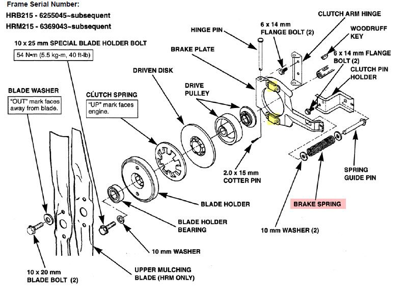

Robert, thanks for the response. I did not explain well enough. There is plenty of oil, nothing was run over. The brake on the bottom of the unit is what is keeping the engine from turning over. Any ideas to what might be causing the brake to stick closed?

So the Roto-Stop system does have brakes (yellow) but they stop just the blade, not the engine. The spring (red) forces the brakes to be applied to the blades, until the blade control lever on the handlebar is engaged and pulled back. This releases the brakes, and engages the clutch so the blades are now connected to the engine and spin.
If any part of this "failed," for example, the clutch froze and would not disengage, you could still pull the engine over with the recoil, just would take more effort.
Since the recoil will not turn over the engine, I'd suspect there is either a failure in the recoil, or some kind of internal engine damage.
If you want to DIY and do all this work yourself, I'd strongly suggest a shop manual, but probably best if you have a Honda dealer inspect and evaluate the problem.
