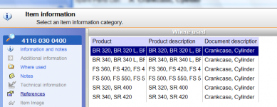

Here are the models that use that crank.
