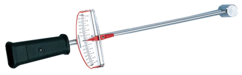

Jul 14, 2019
81
5,912
  • / B&S Valve Adjustment Hiccup (Murphy's law & not a pro)
If you have one of those that you have to crank the handle to set the torque value, remember to set it back to 0 when you are done. If you leave it on say 50 ft lbs for example, it will throw your wrench out of calibration.
Best to get one of those old school beam style.
