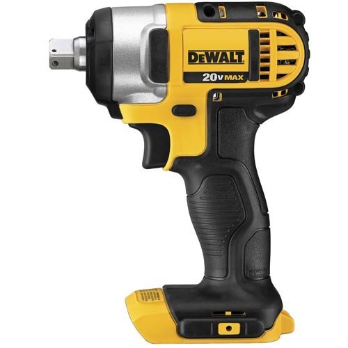

I use Dewalt 1/2" cordless impact.
Extremely compact and very powerful.
Used on heavy rusted blade bolt removal w/ no problem.
Amazon.com: DEWALT DCF880B 20-Volt Li-Ion 1/2-Inch Impact Wrench Kit with Detent Pin: Home Improvement
