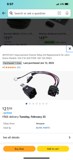

I had the same problem. Solved to buying a $22 part from Amazon. I tried to attatch a screen shot of it but it did not work. I will post this and try again
