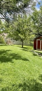

You can see the drop off at the top in front of shed and it ends at the bottom right in front of shed… not the best pic I’ll try to get better tommorrow
