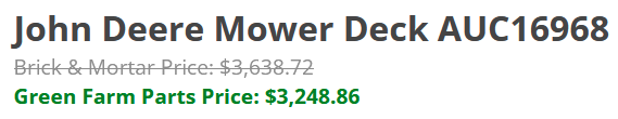

Considering the price of the Mulching deck Bert and I both would spend some time repairing this beast.
Definitely would make sure it is a complete deck and not just a shell.
