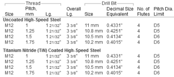

And they actually make a M12-1.00. So all I needed here is the 1.25 and 1.50 pitches.

The bolt - just purchased is a M12 x 1.25 x 30 I have not done many of these. I am not trying to drill out and re tap. I would like to use the correct tap and hopefully clean up the threads. What is the correct tap needed? is it the M12 x 1.25? What is the 30? it looks like pretty fine treads. Tom

I hate to ask this but just how dense are you? A M12-1.25 uses a M12-1.25 tap or die ( the screw itself would need a die and the hole it goes in takes a tap. Since this is a blind hole hole you need a bottoming tap to reach the bottom but you need a taper or plug tap to get started. Most stand length in this size nearly 40mm long and your screw is only 30mm long.
