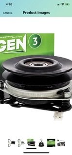

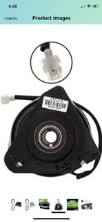

Found this on Amazon and it has two green wires, but I haven’t found where it plugs into the wiring harness 1B2FC7BC-F292-4A99-9D61-B8C942B373B7.jpeg61FD35C4-91AE-4EB6-A3BD-34F0291F828A.jpeg

I found the solution, the green wires go to a black and a red. I looked at my neighbors mower and there it was!

Boy did you get lucky on those PTO the wires usually get rip out their mounting points. And BTW that particular clutch you have is a non polarize version so it doesn't matter which way they connected as long as one is grounded negative and the other positive.
