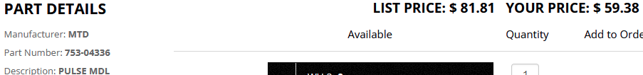

And the coil should only cost $81.81 at a dealer. Below is my cost and resell price.
