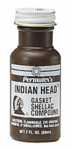

I seem to have 2 welch plugs. When disassembling the carb the first time, one just fell out on its own. I didn't remove the other one because it appeared stuck in there. There's
a little groove/hole on the side that I tried to pry up - but I didn't want to use too much force. Should I just go ahead and really try to pry it out?

Plugs are glued into the carb body. Can be pretty tough to remove. Remove using brute force and a gentle hand simultaneously. The one that fell out needs to be reintalled and sealed. They make Indian Head Shellac which glues and seals these into the carb body. Glue the plug in then seal the round area.

Thanks for the bread tie tip! That's a great idea. I appreciate the tip on the shellac too.
