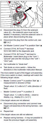

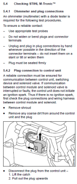

This should help some. Most of the information is dealer only and all is copyrighted. I actually not suppose to have any of this info on hand. Just know a good source for the info.
But here is a few extracts. Please carefully all the instructions especially section 5.4.2. The following info should be available the owner of the saw in the first place under the right to repair.
