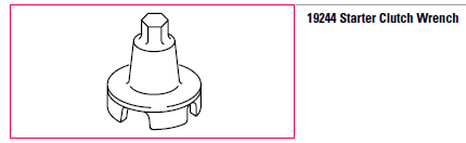

This is the tool used to removal and tightening of this clutch to 55 ft/lbs.
tool in use.
