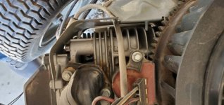

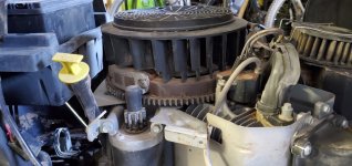

Attached picture same angle as the previous last after I cleaned it out beyond the dipstick. It's the dust that collects and turns solid everywhere. It was all up through there to the steering. The tractor is probably 10 pound lighter after removing it.
I cleaned out below the air filter. There was a thin layer of sludge. I've always been afraid to clean it out as it wasn't going anywhere and I didn't want to drop some down the openings. It's easier to get at with the shroud off. Down at the bottom of those openings I stuck a pipe cleaner and there's about an eighth inch of sludge both sides. I really don't want to be taking the carburetor off.

With that amount of unfiltered dirt going into the engine I wouldn't be surprised if it hasn't wiped the rings and worn the cylinders beyond max. Keep in mind that sludge you are finding going into the carb it only takes 1 tsp to sandpaper the rings and cylinder walls to beyond limits.

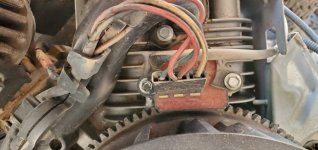

The fins on the cylinders look clean. No dried mud between them. Pictures are looking up from below and down. In the earlier picture that dirt in the corner left of the dipstick was blocking up the opening to the bottom of tractor. That could mess with the air flow. It should be a lot better now.
I hadn't thought about using my leaf blower to clean the mower after mowing. It blows pretty hard. That was a good idea. Maybe get all that dirt out under the hood and off the mower bed each time. I have never thought about taking the shroud off to clean. The manual doesn't mention doing that. It just says to clean. Not that I did either.
