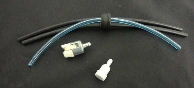

Yeah, you really need to replace the lines along with the grommet. Also, you may have hooked the lines back up incorrectly.

  • / SRM-225 string trimmer, a few question on diagnosing and fixes
What @Rivets said. ☝️
The kit includes new grommets, new lines, and new primer bulbs.
There are two intake manifold block gaskets that you can buy separately. They aren’t normally needed. But, why not? You will already have half of the stuff off.

Thanks for all the great suggestions. Yes, I replaced all the lines, (sorry, forgot to mention), and a new fuel filter as well. I can replace the bulb, but it looks pristine.
Oh, and yes, I only use the 2 stroke pre-mixed fuel that I've used in all my equipment for years (he did not, he mixed his own).
On the tank grommet and the leak, I'm at a bit of a loss. Should I just use some sort of sealer?
When installing tank grommet, spray some lubricant such as WD-40 on tank opening and grommet. Carefully install grommet with small screwdriver and your fingers making sure not to damage grommet. It should seal up correctly.
Or, 2 cycle oil.
It can be a booger to get the grommet in. Just be patient and take care not to damage the grommet.
