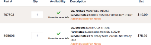

Another big problem is that people don't replace the flat o-rings on the intake manifold and they have air leaks. The OEM get hard and compressed and the cheap AM swell from the ethanol. I stock a dozen of them as i change a lot of them.
