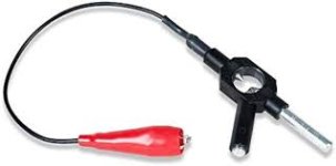

So your word is misfire. Back to the coil again. Get one of these. The Oppama PET-4000 is supreme. You need to rule out SPARK as a cause.
