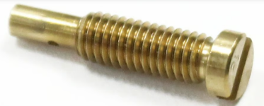

Here's what the "adjuster" looks like. It's all the way in.
Hammermechanicman
Jan 10, 2020
69
3,917
Look at the end of the "adjuster" for a small hole. That is the low speed jet. Make sure it is open and clean.
