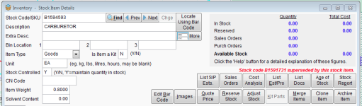

594593 is the Ruixing that is used after 15112900
591731 is the Nikki but Briggs has superseded to the Ruixing 594593.
Drop the B1 prefix I use in house. (As of 07/03/2022 update)
