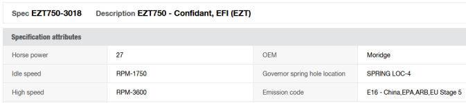

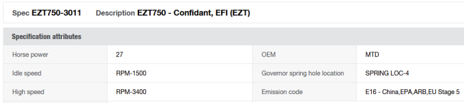

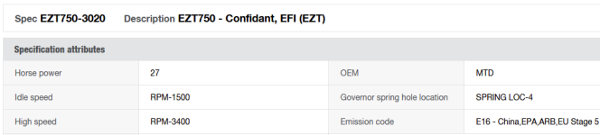

EZT750-3011.
Looks like 1500 and 3400. Thanks, StarTech.

The 1st paragraph sounds like high speed is not adjustable, but the 2nd one makes it sound like it IS adjustable. And StarTech's table above shows differing high speed setting for different versions of the engine.
