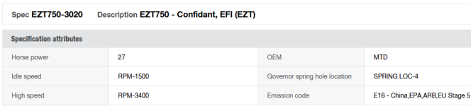

didn't say which spec and three engine were used on the model.
GearHead36
Apr 26, 2023
23
335
EZT750-3011.
Looks like 1500 and 3400. Thanks, StarTech.
BTW, where did you find this? Is there a way for someone like me (non industry professional) to look this up?
123
12,917
Kohler dealer portal. Doubt they just let anyone in the portal.
